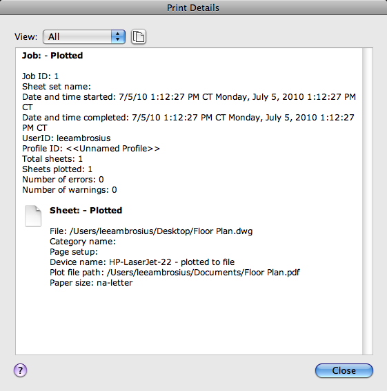

Print Details Dialog Box
Displays information about plotting and publishing jobs that have been completed in the current session.
List of Options
The following options are displayed.
View
Specifies what is displayed. You can also right-click in the details area and click View Errors Only or View All to change this setting.
All
Displays information about all completed print and publish jobs and sheets within those jobs.
Errors
Lists errors that have occurred as jobs were printed or published.
Copy to Clipboard
Copies all highlighted text to the Clipboard.
Details Area
Lists details of completed print and publish jobs.
