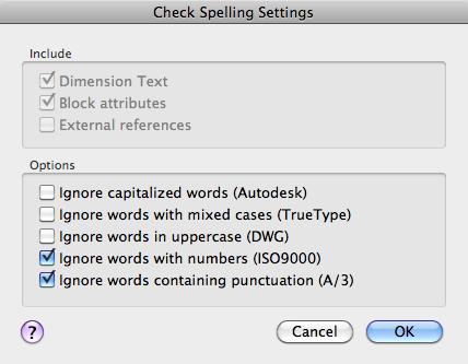

Check Spelling Settings Dialog Box
Provides options to change the way the default behavior of the spelling checker in the In-place Text editor.
Summary
Specifies specific text options that will be checked in your drawing.
List of Options
The following options are displayed.
Include
Dimension Text
Searches dimension text.
Block Attributes
Searches block attributes text for spelling errors.
External References
Specifies to search external references for spelling errors.
Options
Ignore Capitalized Words
Specifies to ignore capitalized words.
Ignore Words with Mixed Cases
Specifies to ignore words that contain uppercase and lowercase letters.
Ignore Words in Uppercase
Specifies to ignore words that are in all uppercase.
Ignore Words with Numbers
Specifies to ignore words that include numbers.
Ignore Words Containing Punctuation
Specifies to ignore words that contain punctuation.
