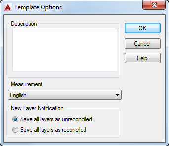

Sets drawing template options.
The Template Options dialog box displays automatically after you specify the files of type as *.dwt, enter the template file name, and click Save.
The following options are displayed.
Specifies a description for the drawing template. This description is displayed when you choose the template in the Startup dialog box or in the Create New Drawing dialog box.
Specifies whether the drawing template uses English (imperial) or metric units.
Saves the template file with its layers set as unreconciled, which means that a layer baseline is not created.
See Reconcile New Layers for more information about unreconciled layers.
Saves the template file with its layers set as reconciled, which results in creating a layer baseline.
See Reconcile New Layers for more information about reconciled layers.
