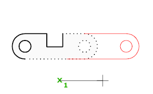

Summary
Objects that are partially enclosed by a crossing window are stretched. Objects that are completely enclosed within the crossing window, or that are selected individually, are moved rather than stretched. Several objects such as circles, ellipses, and blocks, cannot be stretched.
