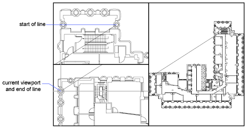

To Draw Across Two Model Space Viewports
In a large drawing, you can use this method to draw a line from a detail in one corner to a detail in a distant corner.
  1. Start the line in the current viewport.
  2. Make another viewport current by clicking within it, and then specify the endpoint of the line in the second viewport.
