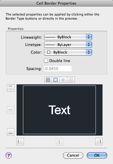

Cell Border Properties Dialog Box
Sets the properties of the borders of table cells.
Access Methods
 Pointing device: With a table cell selected and the Properties Inspector palette open, click All. Under the Cell section, click the button to the right of the Border Style field.
List of Options
The following options are displayed.
Properties
Controls the properties of the borders of the selected table cells.
Lineweight
Sets the lineweight to be used for borders that are displayed. If you use a heavy lineweight, you may have to change the cell margins.
Linetype
Sets the linetype to be used for borders that are displayed.
Color
Sets the color to be used for borders that are displayed.
Double Line
When checked, a double line border will be added to the selected cells.
Spacing
Determines the spacing of double-line borders. The default value is .1800.
Preview
Displays a preview of how the borders of the selected table will look.
Note: Linetypes will not display in the preview.
All Borders
Applies the border properties settings to all borders of the selected table cells.
Outside Borders
Applies the border properties settings to the outside borders of the selected table cells.
Inside Borders
Applies the border properties settings to the inside borders of the selected table cells.
No Borders
Applies the border properties settings to none of the borders of the selected table cells.
Top Border
Applies the border properties setting to the top borders of the selected table cells.
Inside Horizontal Border
Applies the border properties setting to the inside horizontal borders of the selected table cells.
Bottom Border
Applies the border properties setting to the bottom borders of the selected table cells.
Left Border
Applies the border properties setting to the left borders of the selected table cells.
Inside Vertical Border
Applies the border properties setting to the inside vertical border of the selected table cells.
Right Border
Applies the border properties setting to the right border of the selected table cells.
