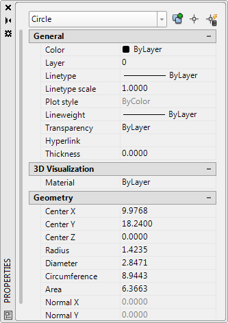

Displays the properties of the selected object or set of objects.
When more than one object is selected, only those properties common to all selected objects are displayed. When no objects are selected, only the current settings of general properties are displayed.
You can specify a new value to modify any property that can be changed. Click the value and use one of the following methods:
When you view properties of AutoCAD objects in AutoCAD LT, some properties might be unavailable.
The following options are displayed.
Displays the type of object that is selected.
Turns the PICKADD system variable on (1) and off (0). When PICKADD is on, each object selected, either individually or by windowing, is added to the current selection set. When PICKADD is off, selected objects replace the current selection set.
Selects desired objects using any selection method. The properties common to the selected objects are displayed in the Properties palette. You can then modify the properties of the selected objects in the Properties palette, or you can make other changes to the selected objects by entering an editing command.
Displays the Quick Select dialog box. Use Quick Select to create selection sets based on filtering criteria.
