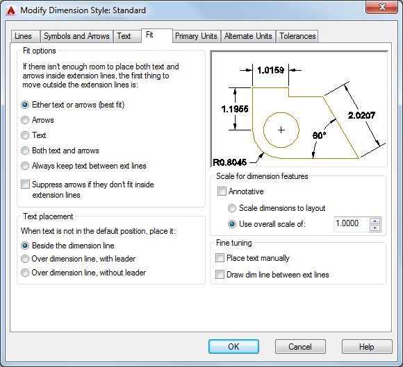

Controls the placement of dimension text, arrowheads, leader lines, and the dimension line.
The following options are displayed.
Controls the placement of text and arrowheads based on the space available between the extension lines.
When space is available, text and arrowheads are placed between the extension lines. Otherwise, text and arrowheads are placed according to the Fit options. (DIMATFIT, DIMTIX, and DIMSOXD system variables)
Moves either the text or the arrowheads outside the extension lines based on the best fit (DIMATFIT system variable).
Moves arrowheads outside the extension lines first, then text (DIMATFIT system variable).
Moves text outside the extension lines first, then arrowheads (DIMATFIT system variable).
When not enough space is available for text and arrowheads, moves both outside the extension lines (DIMATFIT system variable).
Always places text between extension lines. (DIMTIX system variable)
Suppresses arrowheads if not enough space is available inside the extension lines. (DIMSOXD system variable)
Sets the placement of dimension text when it is moved from the default position, that is, the position defined by the dimension style. (DIMTMOVE system variable)
If selected, moves the dimension line whenever dimension text is moved. (DIMTMOVE system variable)
If selected, dimension lines are not moved when text is moved. If text is moved away from the dimension line, a leader line is created connecting the text to the dimension line. The leader line is omitted when text is too close to the dimension line. (DIMTMOVE system variable)
If selected, dimension lines are not moved when text is moved. Text that is moved away from the dimension line is not connected to the dimension line with a leader. (DIMTMOVE system variable)
Sets the overall dimension scale value or the paper space scaling.
Specifies that the dimension is annotative. Annotative objects and styles are used to control the size and scale at which annotation objects are displayed in model space or a layout.
Determines a scale factor based on the scaling between the current model space viewport and paper space. (DIMSCALE system variable)
When you work in paper space, but not in a model space viewport, or when TILEMODE is set to 1, the default scale factor of 1.0 is used or the DIMSCALE system variable.
Sets a scale for all dimension style settings that specify size, distance, or spacing, including text and arrowhead sizes. This scale does not change dimension measurement values. (DIMSCALE system variable)
Provides additional options for placing dimension text.
Ignores any horizontal justification settings and places the text at the position you specify at the Dimension Line Location prompt. (DIMUPT system variable)
Draws dimension lines between the measured points even when the arrowheads are placed outside the measured points. (DIMTOFL system variable)
Displays sample dimension images that show the effects of changes you make to dimension style settings.
