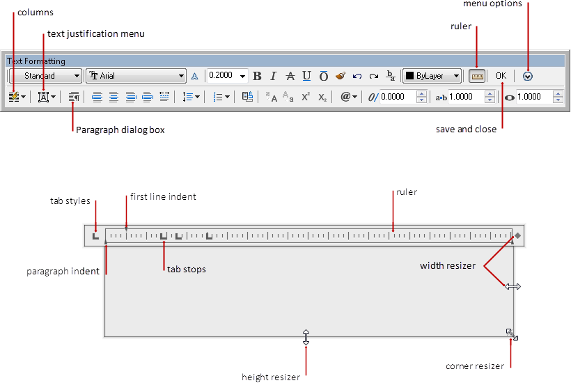

The In-Place Text Editor includes
When a table cell is selected for editing, the In-Place Text Editor displays column letters and row numbers.
The following options are displayed.

Controls display of the Text Formatting toolbar. To restore display of the toolbar, right-click in the text area of the editor, and click Editor Settings
Show Toolbar. This option is controlled by the MTEXTTOOLBAR system variable
Expands the Text Formatting toolbar to show more options.
Controls the display of the ruler.
