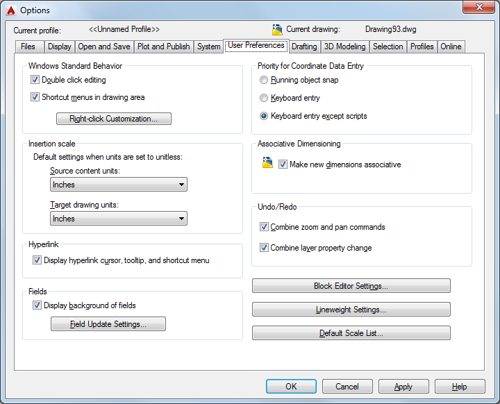

Controls options that optimize the way you work.
The following options are displayed.
Controls keystroke and right-click behavior.
Controls the double click editing behavior in the drawing area.
(DBLCLKEDIT system variable)
Controls whether Default, Edit, and Command mode shortcut menus are available in the drawing area.
( SHORTCUTMENU system variable)
If this option is cleared, right-click is interpreted as Enter.
Displays the Right-Click Customization dialog box. This dialog box provides further definition for the Shortcut Menus in Drawing Area option. ( SHORTCUTMENU system variable)
Controls the default scale for inserting blocks and drawings into a drawing.
Sets source content units value when INSUNITS is set to 0.
(INSUNITSDEFSOURCE system variable)
If Unspecified-Unitless is selected, the object is not scaled when inserted.
Sets target drawing units value when INSUNITS is set to 0.
( INSUNITSDEFTARGET system variable)
Sets preferences related to fields.
Controls whether fields are displayed with a gray background.
( FIELDDISPLAY system variable)
When this option is cleared, fields are displayed with the same background as any text.
Displays the Field Update Settings dialog box. (FIELDEVAL system variable)
Controls whether coordinates entered on the command line will override running object snaps.
( OSNAPCOORD system variable)
Specifies that running object snaps override coordinate entry at all times. (OSNAPCOORD system variable = 0)
Specifies that coordinate entry overrides running object snaps at all times. (OSNAPCOORD system variable = 1)
Specifies that coordinate entry overrides running object snaps, except in scripts. (OSNAPCOORD system variable = 2)
Controls whether associative dimension objects or legacy-style, nonassociative dimension objects are created.
Creates associative dimensions, which automatically adjust their locations, orientations, and measurement values when the geometric objects associated with them are modified. (DIMASSOC system variable)
Controls settings that relate to the display properties of hyperlinks.
Controls the display of the hyperlink cursor, tooltips, and shortcut menu.
(HYPERLINKOPTIONS command)
The shortcut menu provides additional hyperlink options when you select an object that contains a hyperlink and then right-click in the drawing area.
Controls Undo and Redo for Zoom and Pan.
Groups multiple and consecutive zoom and pan commands as a single action for undo and redo operations.
Groups layer property changes made from the Layer Properties Manager.
Displays the Block Editor Settings dialog box. Use this dialog box to control the environment settings of the Block Editor.
Displays the Lineweight Settings dialog box. Use this dialog box to set lineweight options, such as display properties and defaults, and also to set the current lineweight.
Displays the Default Scale List dialog box to manage the default list of scales displayed in several dialog boxes associated with layout viewports and plotting. You can delete all custom scales and restore the default list of scales.
