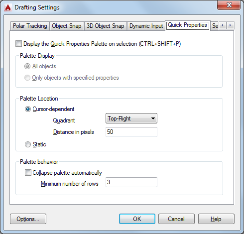

Specifies the settings for displaying the Quick Properties palette.
Displays the Quick Properties palette when you select objects, depending on the object type. (QPMODE system variable)
The PICKFIRST system variable must be turned on to display the Quick Properties palette. Alternatively, you can enter the QUICKPROPERTIES command to select objects.
Sets the display settings of the Quick Properties palette. See Customize Quick Properties for more information.
Sets the Quick Properties palette to display for any selection of objects, not just the object types specified in the Customize User Interface (CUI) editor to display properties.
Sets the Quick Properties palette to display only the object types that are specified in the Customize User Interface (CUI) editor to display properties.
Controls where the Quick Properties palette is displayed.
The Quick Properties palette displays in a location relative to the cursor. (QPLOCATION system variable)
Specifies which of four quadrants relative to the cursor to display the Quick Properties palette relative to the cursor location. The default location is above and to the right of the cursor.
Specifies the distance in pixels from the cursor to display the Quick Properties palette. You can specify integer values from 0 to 400.
Displays the Quick Properties palette in a fixed location. You can specify a new location by dragging the palette. (QPLOCATION system variable)
Sets the behavior of the Quick Properties palette.
The Quick Properties palette displays only the specified number of properties. The palette expands when the cursor rolls over it.
Sets the number of properties that the Quick Properties palette displays when it is collapsed. You can specify integer values from 1 to 30.
