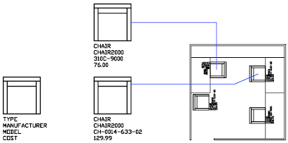

The following illustration shows a "chair" block with four attributes: type, manufacturer, model, and cost. Because the tags were set up as variables, specific information about each instance could be added for each inserted block reference.

To use several attributes together, define them and then include them in the same block. For example, you can define attributes tagged "Type," "Manufacturer," “Model,” and “Cost,” and then include them in a block called CHAIR.
