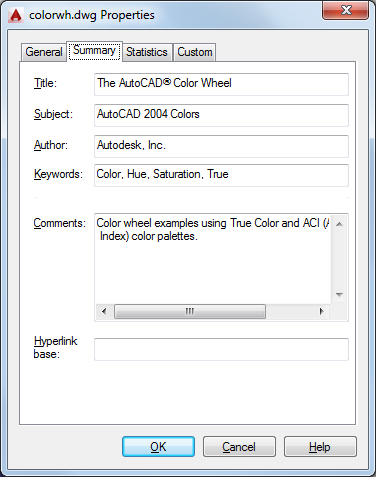

Defines properties such as author, title, and subject.
For example, you can add keywords to all your drawing files and then use DesignCenter™ to search for all drawing files with a particular keyword.
The following options are displayed.
Specifies the title you want to use when searching for this drawing. The title can be different from the drawing file name.
Specifies the subject of the drawing. You can use the subject name to group drawings that have the same subject.
Specifies the author of the drawing. The author name can only be entered or changed by the user. To change the author, delete the existing name and enter a new one.
Specifies the keywords you want to use to locate the drawing.
Provides a space to add comments to the drawing.
Specifies the base address that is used for all relative links inserted within the drawing. You can specify an Internet location, for example, http://www.autodesk.com, or a path to a folder on a network drive.
