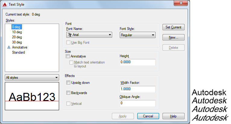

A single font can be used by more than one text style. If your company has a standard font, you can modify other text style settings to create a set of text styles that use this standard font in different ways.
The following illustration shows the same font used by different text styles that use different obliquing settings to define the slant of the text.
