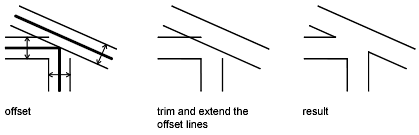

Offset an object to create a new object whose shape is parallel to the original object.
For example, if you offset a circle or an arc, a larger or smaller circle or arc is created, depending on which side you specify for the offset. If you offset a polyline, the result is a polyline that parallels the original.

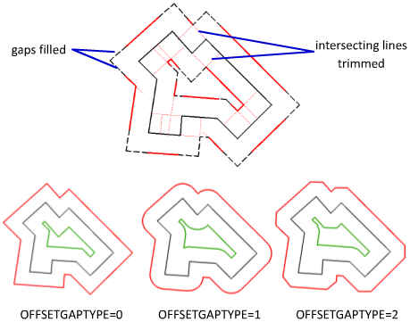

2D polylines are offset as individual line segments, resulting in either intersections or gaps between segments. To complete the offset, intersecting lines are trimmed and gaps are filled.
Splines are trimmed automatically when the offset distance is larger than can otherwise be accommodated.

With the Corner option, you can specify sharp corners or rounded corners for the polyline. External and internal corners create rounded corners differently depending whether the corners are concave or convex—the radius of the arcs maintain the specified offset distance.
