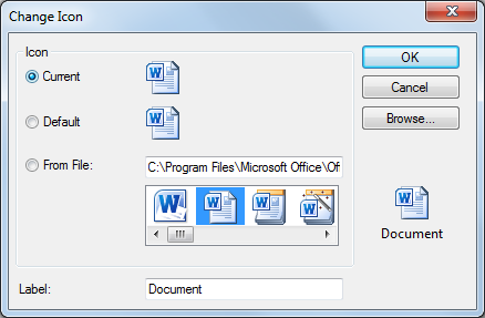

Changes the icon for an embedded or linked object in a drawing.
The following options are displayed.
Specifies an icon to represent an embedded or linked object.
Specifies the currently selected icon.
Specifies the default icon for the source application.
Specifies an icon from a file (valid types include EXE, DLL, and ICO).
Specifies a caption for the icon. The file type is displayed unless you specify otherwise.
Displays the Browse dialog box (a standard file selection dialog box), in which you can select an icon from a file.
