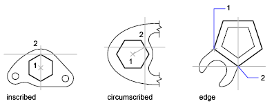

Polygons can be used to draw equilateral triangles, squares, pentagons, hexagons, and other multi-sided figures.
The following illustrations show polygons created using three methods: inscribed, circumscribed, and edge. In each case, two points are specified.
