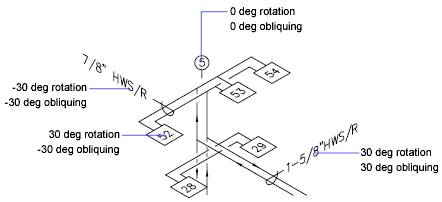

The obliquing angle determines the forward or backward slant of the text. The angle represents the offset from 90 degrees.
Entering a value between -85 and 85 makes the text oblique. A positive obliquing angle slants text to the right. A negative obliquing angle slants text to the left.
. Find A positive value slants text to the right. A negative value slants text to the left.
