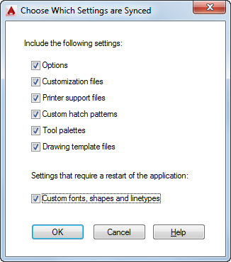

Specifies which settings are synchronized with Autodesk 360.
The following options are displayed.
Synchronizes user profiles and all other settings specified in the Options dialog box.
Include all CUI and CUIx files, menu files, workspace settings, custom icons, and so on.
Includes printer configuration files (PC3), printer description files (PMP), and Plot Style Tables (CTB, STB).
Includes all custom hatch pattern (PAT) files.
Includes all tool palette (ATC, AWS) files.
Includes drawing template (DWT) files.
For a complete list of file types that are synced, refer to Migrating and Transferring Custom Settings Comparison below.
