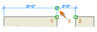

For the 8'-0" dimension below, you can use the other method. You start the DIMLINEAR command, click two endpoints (1 and 2) and then the location of the dimension line (3). To line up the dimension lines point 3 was snapped to the endpoint of the previously created dimension line.

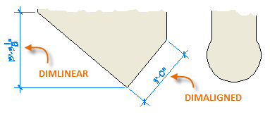

Use the DIMLINEAR command to create horizontal and vertical dimensions, and the DIMALIGNED command to create dimensions that are parallel to an object.

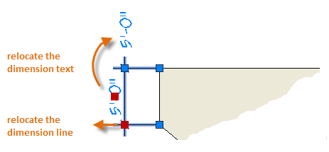

For simple adjustments to dimensions, nothing is faster than using grips.
In this example, you select the dimension to display its grips. Next, click the grip on the dimension text and drag it to a new location, or click one of the grips at the end of the dimension line and drag the dimension line.
