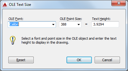

Maps the point size of one of the fonts in an OLE object to a text height in the drawing.
The OLE object is scaled automatically to accommodate the size of the text.
The following options are displayed.
Displays a list of the fonts used in the OLE object.
Displays a list of the point sizes available for the selected font.
Sets a text height for the font at the selected point size.
Restores the OLE object to its size when it was inserted in the drawing.
