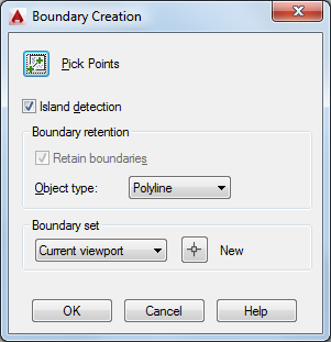

Defines the object type, boundary set, and island detection method for creating a region or polyline based on objects that enclose a specified point.
The following options are displayed.
Determines a boundary from existing objects that form an enclosed area around the specified point.
Controls whether the BOUNDARY command detects internal closed boundaries, called islands.
Controls the type of the new boundary object. BOUNDARY creates the boundary as a region or a polyline object.
Defines the set of objects BOUNDARY analyzes when defining a boundary from a specified point.
Defines the boundary set from everything in the current viewport extents. Selecting this option discards any current boundary set.
Prompts you to select the objects that define the boundary set. BOUNDARY includes only the objects that can be used to create a region or closed polyline when it constructs the new boundary set.
For more information about the options in this dialog box, see the HATCH command.
