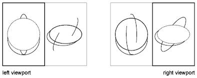

Specifies the projection method used when trimming objects.

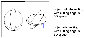

Specifies no projection. The command trims only objects that intersect with the cutting edge in 3D space.

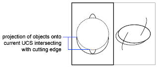

Specifies projection onto the XY plane of the current UCS. The command trims objects that do not intersect with the cutting edge in 3D space.
Specifies projection along the current view direction. The command trims objects that intersect the boundary in the current view.
Determines whether an object is trimmed at another object's extrapolated edge or only to an object that intersects it in 3D space.
Extends the cutting edge along its natural path to intersect an object in 3D space.
Specifies that the object is trimmed only at a cutting edge that intersects it in 3D space.
