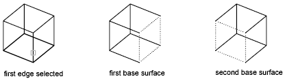

You can also select the edge of a 3D solid to chamfer and then indicate which one of two adjacent surfaces is the base surface. (Not available in AutoCAD LT.)
Entering o or pressing Enter sets the selected surface as the base surface. Entering n selects either of the two surfaces adjacent to the selected edge.

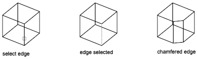

After you select the base surface and the chamfer distances, select the edges of the base surface to chamfer. You can select edges individually or all the edges at once.
Selects an individual edge to chamfer.

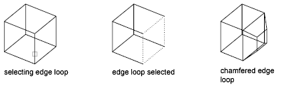

Switches to Edge Loop mode.
