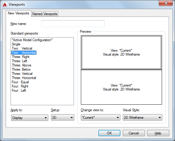

Specifies a name for the new model space viewport configuration. If you do not enter a name, the viewport configuration is applied but not saved. If a viewport configuration is not saved, it cannot be used in a layout.
Lists and sets the standard viewport configurations, including CURRENT, which is the current configuration.
Displays a preview of the viewport configuration you select and the default views assigned to each individual viewport in the configuration.
Applies the model space viewport configuration to the entire display or to the current viewport.
Specifies either a 2D or a 3D setup. When you select 2D, the new viewport configuration is initially created with the current view in all of the viewports. When you select 3D, a set of standard orthogonal 3D views is applied to the viewports in the configuration.
Replaces the view in the selected viewport with the view you select from the list. You can choose a named view, or if you have selected 3D setup, you can select from the list of standard views. Use the Preview area to see the choices.
Applies a visual style to the viewport. All available visual styles are displayed.

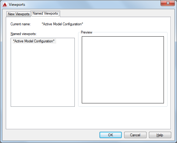

Lists all saved model viewport configurations in the drawing.
Displays the name of the current viewport configuration.
Displays a list of standard viewport configurations and configures layout viewports.
Specifies the spacing you want to apply between the layout viewports you are configuring.
Displays any saved and named model space viewport configurations for you to use in the current layout. You cannot save and name a layout viewport configuration.
