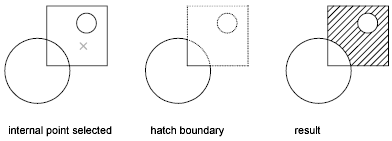

Determines a hatch boundary by selecting a point within an enclosed area formed by one or more objects.

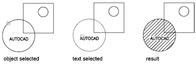

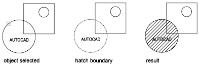

Adds hatch areas to the selected hatch by determining a boundary based on selected objects.
When you use this option, interior objects are not detected automatically. You must select the objects within the selected boundary to hatch or fill those objects according to the current island detection style.
In order to create an unhatched space around text, include the text in the selection set.
