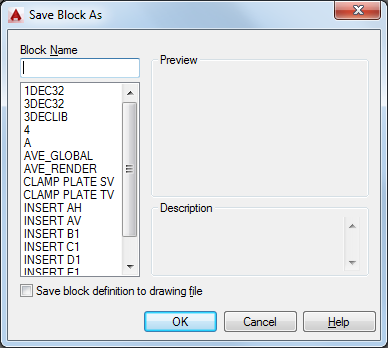

Saves a copy of the current block definition under a new name.
The following options are displayed.
Specifies a new name under which to save a copy of the current block definition.
Displays a list of block definitions that are saved in the current drawing.
Displays a preview of the selected block definition.
Displays the description saved with the block definition.
Saves the block definition as a drawing file. Selecting a pre-existing drawing file overwrites the saved file. By default, the block name specified is taken as the drawing file name.
