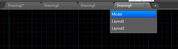

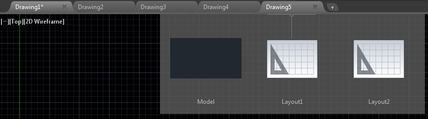

Controls the type of preview, list view or thumbnail view, when you hover over a file tab.
| Type: | String |
| Saved in: | Registry |
| Initial value: | 1 |
1 |
Displays the thumbnail view. |
0 |
Displays the list view. |
Thumbnail View
List View
Use this variable to choose either a thumbnail preview or a list view of opened drawings.
