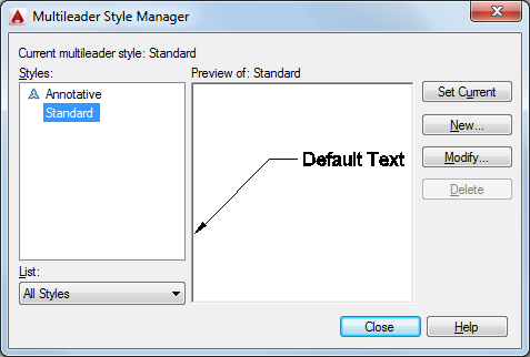

Creates and modifies styles that you can use to create multileader objects
The appearance of multileaders is controlled by multileader styles. These styles specify formatting for landing lines, leader lines, arrowheads, and content.
You can create, modify, and delete multileader styles.
The following options are displayed.
Displays the name of the multileader style that is applied to multileaders you create. The default multileader style is Standard.
Displays a list of multileader styles. The current style is highlighted.
Controls the contents of the Styles list. Click All Styles to display all multileader styles available in the drawing. Click Styles In Use to display only the multileader styles that are referenced by multileaders in the current drawing.
Displays a preview image of the style that is selected in the Styles list.
Sets the multileader style selected in the Styles list as the current style. All new multileaders are created using this multileader style.
Displays the Create New Multileader Style dialog box, in which you can define new multileader styles.
Displays the Modify Multileader Style dialog box, in which you can modify multileader styles.
Deletes the multileader style selected in the Styles list. A style that is being used in the drawing cannot be deleted.
