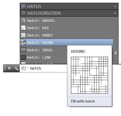

Example: Suppose you want to insert a hatch pattern. When you enter hatch at the Command prompt and press the Tab key to cycle through options, the command line suggestion list expands to include available hatch patterns. Drag the scroll bar to display additional hatches and gradients. You can see a thumbnail of each option by hovering over the name.
Select a hatch name and click within a closed area or object in the drawing to insert it.

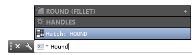

You can also search by the name of the content. For example, to find the hatch type "Hound," enter hound. The content category and name are displayed in the suggestion list.
You can select the name and click inside a closed area in the drawing area to insert the pattern.
