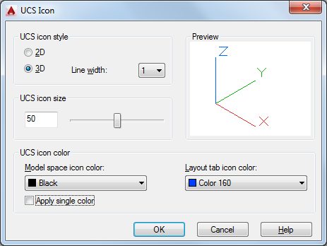

Controls the style, visibility, and location of the UCS icon.
The following options are displayed.
Specifies display of either the 2D or the 3D UCS icon and its appearance.
Displays a 2D icon without a representation of the Z axis.
Displays a 3D icon.
Controls the line width of the UCS icon if the 3D UCS icon is selected.
Displays a preview of the UCS icon in model space.
Controls the size of the UCS icon as a percentage of viewport size. The default value is 50, and the valid range is from 5 to 95. Note that the size of the UCS icon is proportional to the size of the viewport in which it is displayed.
Controls the colors of the UCS icon in model space viewports and in layout tabs.
Controls the color of the UCS icon in model space viewports.
Controls the UCS icon color in layout tabs.
Applies the selected Model space icon color to all axes of the 2D UCS icon.
