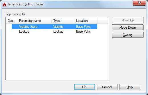

Specifies the grip-cycling order for the insertion point of a dynamic block reference.
When you insert a dynamic block reference in a drawing, you can use the Ctrl key to cycle through the grips that have cycling turned on in the block definition. The grip you select as you cycle is used as the insertion point for the block reference.
The following options are displayed.
Lists the grips in the dynamic block definition. A check mark in the cycling column indicates that cycling is turned on for that grip.
Moves the selected grip up in the cycling order for the dynamic block reference.
Moves the selected grip down in the cycling order for the dynamic block reference.
Turns cycling on or off for the selected grip. A check mark in the cycling column indicates that cycling is turned on for that grip.
