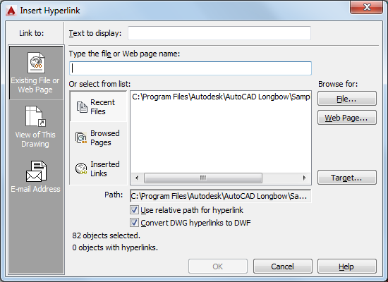

The Insert Hyperlink dialog box has three tabs under Link To.
Creates a hyperlink to an existing file or web page.
Specifies the file or web page to associate with the hyperlink. The file can be stored locally, on a network drive, or on an Internet or intranet location.
Displays a list of recently linked files, from which you can select one to link to.
Displays a list of recently browsed web pages, from which you can select one to link to.
Displays a list of recently inserted hyperlinks, from which you can select one to link to.
Opens the Browse the Web - Select Hyperlink dialog box (a standard file selection dialog box), in which you can navigate to the file that you want to associate with the hyperlink.
Opens the browser, in which you can navigate to a web page that you want to associate with the hyperlink.
Opens the Select Place in Document dialog box, in which you can select a named location in a drawing to link to.
Displays the path to the file associated with the hyperlink. If Use Relative Path for Hyperlink is selected, only the file name is listed. If Use Relative Path for Hyperlink is cleared, the full path and the file name are listed.
Sets a relative path for hyperlinks. If you select this option, the full path to the linked file is not stored with the hyperlink. The relative path is set to the value specified by the HYPERLINKBASE system variable or, if no value is specified for HYPERLINKBASE, to the current drawing path. If this option is cleared, the full path to the associated file is stored with the hyperlink.
Specifies that the DWG hyperlink will convert to a DWF file hyperlink when you publish or plot the drawing to a DWF file.

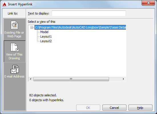

Specifies a named view in the current drawing to link to.
Displays an expandable tree view of the named views within the current drawing, from which you can select one to link to.

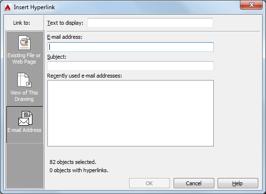

Specifies an email address to link to. When the hyperlink is executed, a new email is created using the default system email program.
Specifies an email address.
Specifies a subject for the email.
Lists recently used email addresses, from which you can select one to use for the hyperlink.
