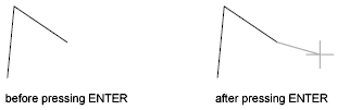

Continues a line from the endpoint of the most recently drawn line.

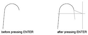

If the most recently drawn object is an arc, its endpoint defines the starting point of the line, and the line is drawn tangent to the arc.

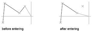

Erases the most recent segment of a line sequence.
Entering u more than once backtracks through line segments in the order you created them.
