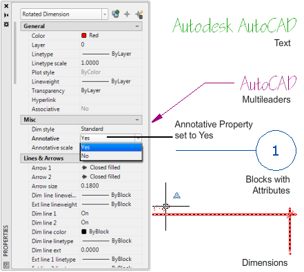

Annotation objects include dimensions, notes, and other types of explanatory symbols or objects commonly used to add information to your drawing.
Annotation objects provide information about a feature, such as the length of a wall, the diameter of a fastener, or a detail callout. Typically, annotation objects are scaled differently than the views of the drawing, and depend on the scale of how they should appear when plotted.
You can control the method that an annotation object is scaled by defining the object either as non-annotative or annotative.
