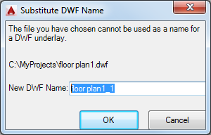

Allows you to rename a DWF underlay if the name is not unique.
The names of DWF or DWFx references you attach must be unique. Attempts to attach two DWF or DWFx references that have the same name displays the Substitute DWF Name dialog box.
Enter a unique name for the DWF or DWFx underlay you are attempting to attach.
Once a new name is supplied, you can continue with the attachment process.
