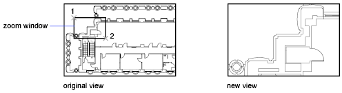

You can quickly zoom on a rectangular area of your drawing by specifying two diagonal corners of the area you are interested in.
The lower-left corner of the area you specify becomes the lower-left corner of the new display. The shape of the zoom area you specify does not correspond exactly to the new view, which must fit the shape of the viewport.

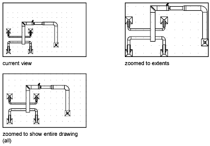

ZOOM Objects displays a view with the largest possible magnification that includes only selected objects.
ZOOM Extents displays a view with the largest possible magnification that includes all of the objects in the drawing. This view includes objects on layers that are turned off but does not include objects on frozen layers.
ZOOM All displays either the user-defined grid limits or the drawing extents, whichever view is larger.
