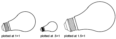

The illustrations show a light bulb plotted at three different scales.
