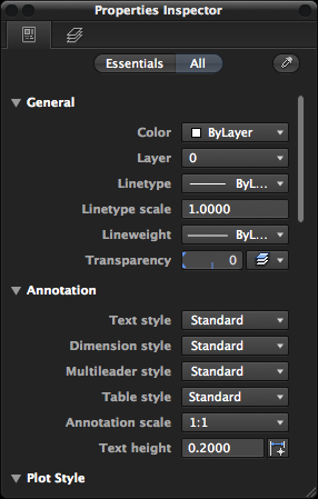

Properties Inspector Palette
Displays the properties of the selected object or set of objects.

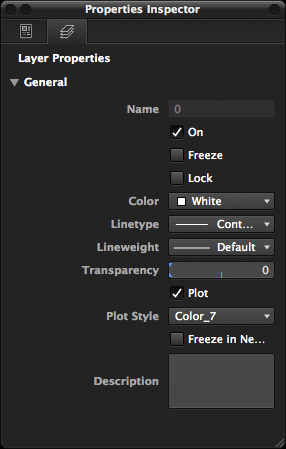

Current Properties
Layer Properties
Summary
When more than one object is selected, only those properties common to all selected objects are displayed. When no objects are selected, only the current settings of general properties are displayed.
You can specify a new value to modify any property that can be changed. Click the value and use one of the following methods:
List of Options
The following options are displayed.
Current
Displays the properties for the current drawing or selected objects.
Layer
Displays the properties for the layer selected in the Layer list of the Layers palette.
Object Type
Displays the type of objects that are selected and filters which objects you are modifying.
Essentials
Displays the most commonly edited or viewed properties for the current drawing or selected objects.
All
Displays all the properties associated with the current drawing or the selected objects.

Drawing/Objects/Layer Properties
Displays a list of available properties that can currently be edited. The list of properties show is based on the following conditions:
  • No objects selected in the current drawing. Drawing specific properties are displayed.
  • Objects selected in the current drawing. Properties common to all selected objects are displayed.
  • Layer selected from the Layer list in the Layers palette. Layer properties are displayed.
