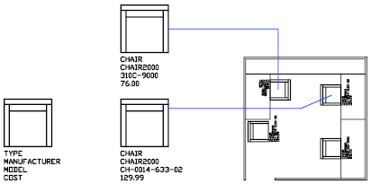

The following illustration shows a "chair" block with four attributes: type, manufacturer, model, and cost. Because the tags were set up as variables, specific information about each instance could be added for each inserted block reference.
