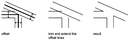

Tip:
An effective drawing technique is to offset objects and then trim or extend their ends.

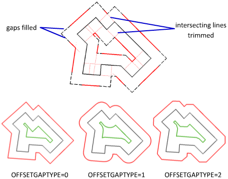

Special Cases for Offset Polylines and Splines
2D polylines are offset as individual line segments, resulting in either intersections or gaps between segments. To complete the offset, intersecting lines are trimmed and gaps are filled.
Splines are trimmed automatically when the offset distance is larger than can otherwise be accommodated.
The OFFSETEDGE command creates a closed polyline or a spline from the edges of a planar face on a 3D solid or surface. Splines result when one or more edge segments cannot be represented as lines, arcs, or a circle. For example
With the Corner option, you can specify sharp corners or rounded corners for the polyline. External and internal corners create rounded corners differently depending whether the corners are concave or convex—the radius of the arcs maintain the specified offset distance.
