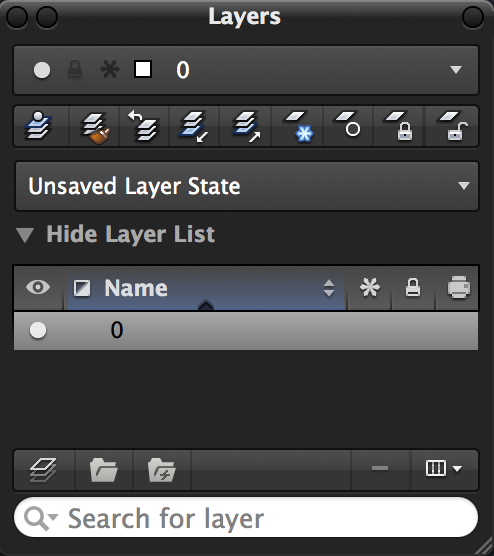

Layers Palette
Displays a list of the layers in the drawing and their properties.
Summary
You can add, delete, and rename layers, change their properties, set property overrides for layout viewports, or add layer descriptions and apply changes in realtime.
When switching layouts or when activating a viewport on named (paper space) layout, the Layers palette is updated and displays the current state of the layer properties in the current space.

The following options are displayed.
Layer Drop-down
Displays the current layer and its color, along with some of its common properties. Click the drop-down list to adjust a layer’s On/Off, Lock/Unlock, or Thaw/Freeze state. You can also select a layer to set it current.
Toolbar
Make Current

Show/Hide Layer List
Displays or hides the Layer list which you use to modify the properties of the layers in the current drawing.
Layer List
Displays the layers and layer groups in the current drawing and their properties.

Display Settings
Displays a menu of options that controls the display of layer groups, layers, and column headers in the Layer list.

Search for Layer
Filters the Layer list by name quickly as you enter characters. This filter is not saved when you close the Layers palette.
