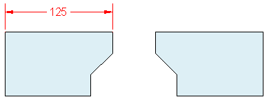

Before you start to draw, you should consider what one drawing unit represents based on what you plan to draw. You can convert a drawing between systems of measurement by scaling it.
Drawing objects are measured in drawing units. Before you start to draw, you must decide what one drawing unit will represent based on what you plan to draw. Then you create your drawing at actual size with that convention.
For example, the objects below could represent two buildings that are each 125 feet long, or a section of a mechanical part that is measured in millimeters.
