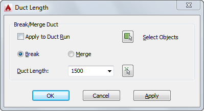

  5. Select the ducts to break or merge, and click Duct tabModify panelDuct Length.
  6. In the Duct Length dialog box, specify the operation:
    To… then…
    apply the length to the entire run select Apply to Duct Run.
    manually select duct segments to modify click (Select Objects), and select specific segments to break or merge.
    break a segment select Break, and enter a value for Duct Length. You can also click (Pick Length), and specify a start and endpoint for the new length.
    merge multiple segments select Merge, click the Select Object icon, and select the segments to merge.
    Note: When merging segments, you cannot cross fittings to join segments.
