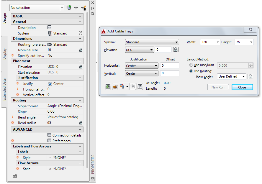

  1. In the Electrical workspace, click Home tabBuild panel. Then click Cable Tray or Conduit.
  2. For the remaining steps, use the Properties palette for conduit settings or the Add Cable Trays dialog box for cable tray settings, as shown next.
    Conduit* (left), cable tray (right)
    *Shows expanded properties including parallel routing mode
