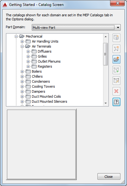

When you start Content Builder, the Getting Started - Catalog Screen dialog box is displayed. This task-specific dialog box acts as a toggle, giving you quick access to the different working environments. The Getting Started - Catalog Screen dialog box has a part catalog browser and an icon bar. You select a catalog from the list of loaded part catalogs that are specified on the MEP Catalogs tab in the Options dialog box. To learn more about a part catalog and how parts are stored in a catalog, see Essentials of Part Catalogs.
Attention: When selecting a catalog, it is important to analyze the type of part you want to create or modify. MvParts belong to a single catalog; however, they can have a different domain for each connection.
When selecting a part to create or modify, the Getting Started - Catalog Screen dialog box detects the part domain, and guides you by activated icons to ensure that you use the correct building environment. Icons are activated based on the selected domain and part in the part catalog browser, whether parametric or block-based. For example, if you select an MvPart part catalog, both the New Block Part and New Parametric Part icons are available. However, if you select a component part catalog such as duct or cable tray, only the New Parametric Part icon is available.
Block-based parts are created and modified through the block-based building environment, and parametric parts are created and modified through the parametric building environment. For more information about the building environments in Content Builder, see Approaches to Creating Parts.

- In the Getting Started - Catalog Screen dialog box, do one of the following:
| If you want to… |
then select a chapter and … |
| create a new block-based MvPart |
click . Enter a name and description for the MvPart, and click OK. The block-based building environment is opened for part creation. |
| create a new parametric MvPart |
click . Enter a name and description for the MvPart, and click OK. The parametric building environment is opened for part creation. |
| add a new chapter for an MvPart |
click , and enter a name. You can add chapters to the catalog or to another chapter. |
| add a new part size to an existing MvPart |
select the MvPart, and click . The appropriate building environment is opened for modifying the part. |
| modify an existing part size |
| delete an MvPart |
select the MvPart, and click . The part is deleted from the catalog and is removed from the tree. |
