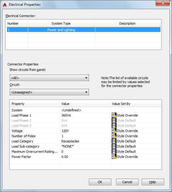

  2. On the Properties palette, expand Advanced, expand Circuits, and click Electrical Properties.
    Note: You can apply these settings later by selecting a device in the drawing and clicking Device tab Circuits panel Circuit Properties .
    The Electrical Properties worksheet lists the connectors on the device and shows the system type and description for each connector. These attributes of the device are determined by the device style, and, to change them, you must modify the connectors in the style.
  3. Under Electrical Connectors, select a connector to configure.
    The properties of the selected connector are displayed under Connector Properties.

  5. For Circuit, select the circuit.
  6. Under Value, specify values for the connector properties.

    As you specify values for the connector properties, the information in the Value Set By column changes accordingly:
    If… then Value Set By is…
    the value of the property matches the value specified in the device style Style Default
    the value of the property does not match the value specified in the device style Style Override
    there is no value specified in the device style empty
    the value of the property is By Circuit in the device style or in the currently selected connector Circuit
