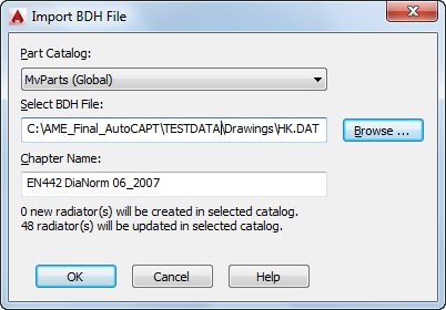

To create custom radiator parts
  1. Click Open BDH Radiator Content.
  2. In the Import BDH File dialog box, under Part Catalog, select the MvParts catalog where the parts will reside.
  3. Under Select BDH File, browse to the BDH file (.dat) and select it.
    Chapter Name updates with the manufacturer name from the file and the targeted number of created or updated parts.
  4. Click OK.
    The software updates the parts in the Plumbing Radiator folder of the MvParts catalog under the specified folder name. AutoCAD MEP organizes parts according to the subchapter names specified in the BDH file and also updates existing radiators.
