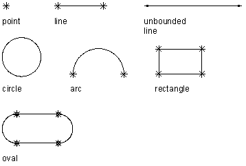

Content Builder provides 9 types of geometry you can use to build the model:
Point
Defined by an X and Y coordinate.
Line
Defined by a position and a direction; constrained by a start point and endpoint.
Unbounded Line
Defined by a position and a direction; infinite in length because it has no constraining start point or endpoint.
Circle
Defined by a center point and a radius.
Arc
Defined by a center point and a radius; constrained by a start point and endpoint.
Rectangle
Defined by lines and points that are constrained to maintain start points and endpoints for each side and perpendicular angle.
Oval
Defined by lines, arc, and points that are constrained to create 2 arcs tangent to 2 lines, with defined start points and endpoints.
