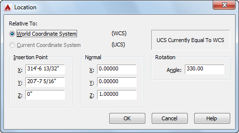

To move or rotate a schematic line using coordinate values
A schematic line has an orientation with respect to the world coordinate system (WCS) or the current user coordinate system (UCS). For example, if the schematic line is parallel to the XY plane, then its normal, or perpendicular, plane is parallel to the Z axis. You can change the orientation of the schematic line by aligning its normal with another axis, such as an isometric axis. You can also rotate the schematic line on its plane by changing the rotation angle.
| If you want to… | then… |
| relocate the schematic line | enter new coordinate values under Insertion Point. |
| locate the schematic line on the XY plane | make the normal of the schematic line parallel to the Z axis: under Normal, enter 1 for Z, and enter 0 for X and Y. |
| locate the schematic line on the YZ plane | make the normal of the schematic line parallel to the X axis: under Normal, enter 1 for X, and enter 0 for Y and Z. |
| locate the schematic line on the XZ plane | make the normal of the schematic line parallel to the Y axis: under Normal, enter 1 for Y, and enter 0 for X and Z. |
| change the rotation of the schematic line | under Rotation, enter a new value for Angle. |
